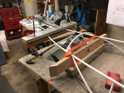

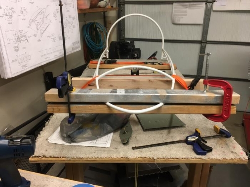

Brief Description:  Final canopy frame bending / fitting
I had to do some work travel to Tucker, GA this week so it's good to get back to the shop. I kept looking at the aft bow of the canopy frame from the aft end of the fuselage and it just looked off. There was a slight twist on the left aft side of the canopy frame where it was up a little higher than the right side and the center. It wasn't much, but just enough that the eye could tell something was out. I took the frame off, localized the aft bow and using two 2"x4"s I took out the twist whereas now the left-center-right portions are all level.
