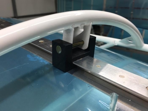

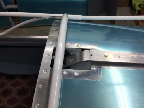

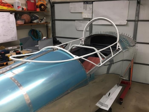

Tonight I temporarily attached the C-658 Rollers, the C-661 Slide Block and the C-806 Anchor Block - for fit purposes. I first taped down the canopy rails, then measured, marked and drilled the holes in the slide block for the clevis pin. I also counterbored the end of the slide block for the head of the clevis pin to fit flush. I still need to drill the other side of the slide block to insert the cotter pin or stailess steel wire to secure the clevis pin.

canopy in position on rollers and slide block
slide block close up with clevis installed and flush
anchor pin in the anchor block
