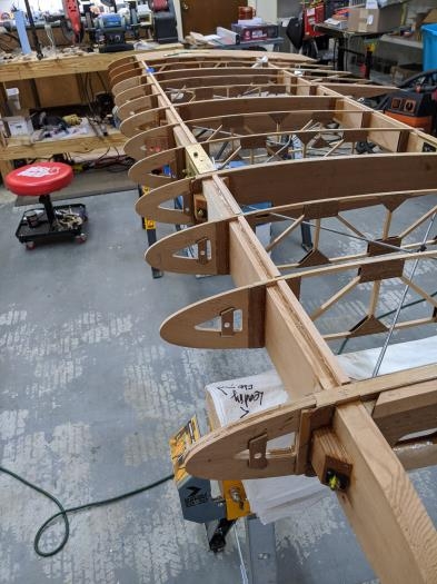

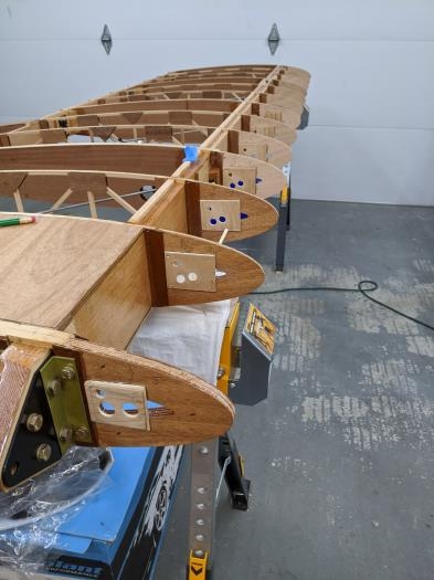

Brief Description:  Pitot and coax brackets

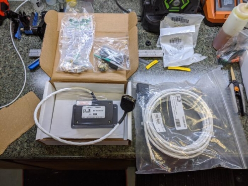

Finalized the locations and hole spacing for plywood plumbing brackets for pneumatic and coax through the nose ribs. Glued and stapled into place. Should have clearance for landing wire pull hardware and the pitot tube based on test fits. Received the Dynon magnetometer and 20ft network cable from Spruce today. Spoke with Dynon sales about aquiring an OAT probe to plug into the mag and mount under the wingtip. Got one coming now. Messaged with KK about mag mounting and wing angle measurements.
ply line brackets all the way across
Magnetometer for the right wingtip
