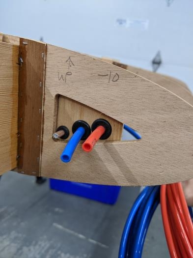

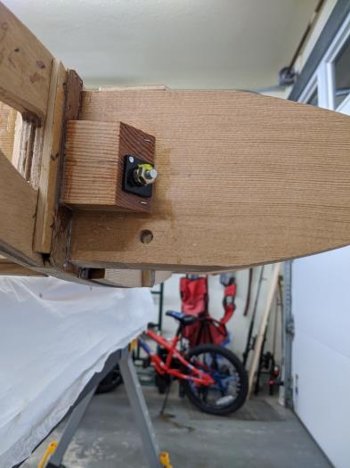

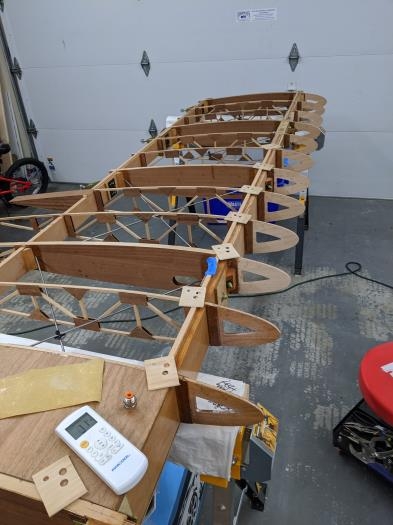

Drilled a 5/16 hole thru the front spar on the left wing outside of the tip rib for the ADS-B coax cable to pass thru. Measured some initial cable supports that will be glued to the nose ribs to support coax and pitot-static tubing. Test fits went well so used a pattern for the common ones and finished making the rest of them for the left wing.
5/16
5/16" hole thru spar for coax
Test fit
Test fit
Support plates done for left wing
