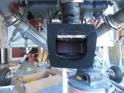

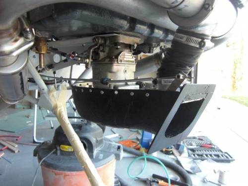

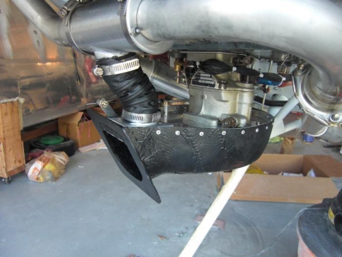

Brief Description:  Air filter box complete
After trimming and mating the inlet and filter box together and happy that they mate well, I riveted the fiberglass filter box body to the aluminum base and attached the carb heat scat hose and carb heat door. The door actuation was installed and actuation from the cockpit was performed and works like a charm!
