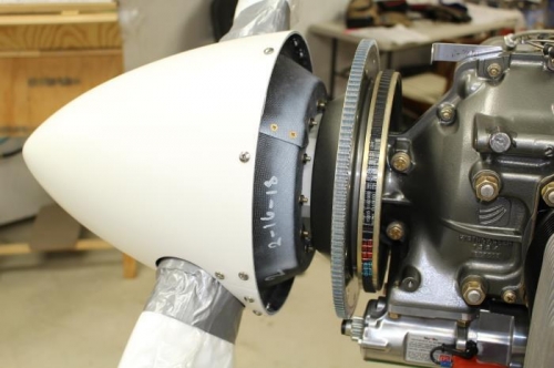

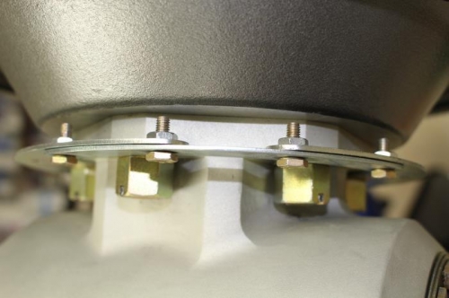

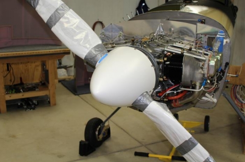

Loosened prop bolts; reversed bolts through spinner plates. Retightened spinner plate bolts, then retightened prop hub bolts. Installed prop bulkheads and dome.
