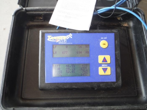

Using Mike M's scales and help, performed empty weight and balance.
Empty Weight Conditions:
0-540 per equipment list
Hartzell HC-C2YR-1BF/F8477 prop with S-1-15 governor
10 quarts oil
No usable fuel
No rear seat
Front seats with Noral 3" seat cushions
Front seatbelts with inertia reels
Left Main Gear = 677 lbs
Right Main Gear = 694 lbs
Tailwheel = 86 lbs
Total Empty Weight = 1457 lbs

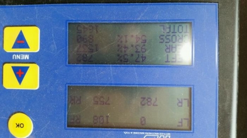

Also weighed aircraft with me in the pilot seat to determine actual moment arm of front seats.
MT weight
MT weight
Weight w/ 188# pilot
