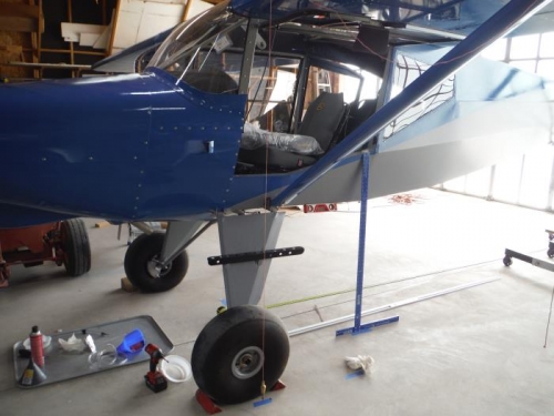

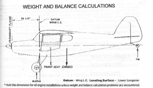

Setup for Weight & Balance
Empty Weight conditions:
Leveled fuselage and measured the following moment arms:
Right Main Gear = -2.75"
Left Main Gear = -2.75"
Tailwheel = 196.25"
Cabin Reference Point (rear edge of floor panel under front seat) = 38.625"
