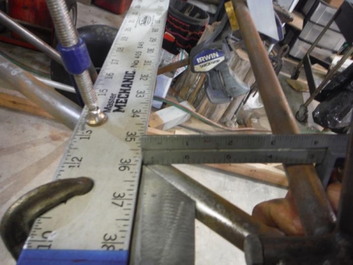

Mount for rudder pedals
Started making .062 plates for rudder pedal mounts. Decided to add 1/2" extra to the plate for floorboard to rest on and attach to. Also have option to move pedals back 1/2" in necessary.
Pedals will be at 4" on center per plans.
