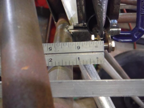

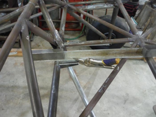

Made control stick mounts. Made level with 1" cross tubes per plans. This is different than other builders who have installed the mounts level with the 3/4" longerons. I couldn't see floorboard being lower than 1" crosstubes. Easier to me to bring tabs up on 3/4" tubes for floorboards. We will see if I'm right.

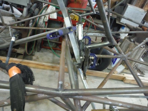

Tacked mounts in place. Jigged CS stick in place.
1" alum angle spacer gives the required 1 5/8" on cable forward of strut hole CL. Drilled holes for control stick mounts.
Started on tubing for mounting bellcrank.

Level with 1" cross tubes.
1" spacer
