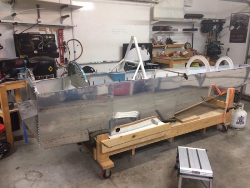

Completely finished with the drilling on the cockpit rails tonight. The angles underneath the rails at F405 and F406 have been drilled to the rails too. I still need to finish drilling those same angles to the F417 stiffener, and those need to be drilled to the F405 and F406 bulkheads.
I then drilled the roll bar to the angles/cockpit rails.

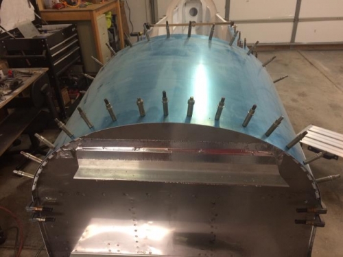

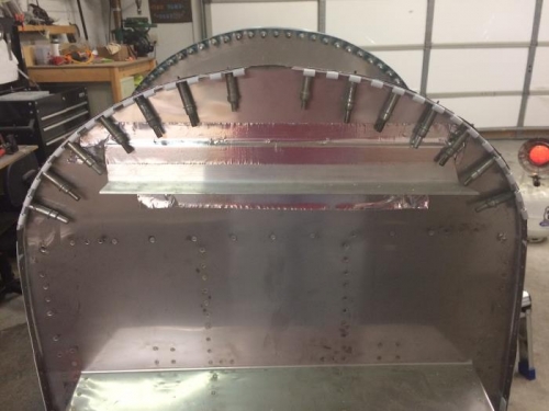

I also drilled the hinge sections that rivet to the firewall. Afterwards, I back drilled the F421 skin to the firewall.
I can take all this stuff apart now. I will drill and attach the nutplates that hold the hinge sections to the firewall and rivet them on. Then I can drill and countersink/dimple as necessary.
Drilling hinge and spacers to the firewall.
Roll bar is drilled to the fuse!
F421 skin drilled front and back.
