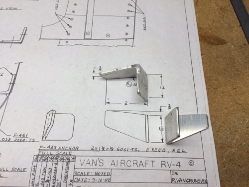

Brief Description:  Worked on front seat, and F443 brackets
Big day today, Worked on the firewall pads that the center of the engine mount attach to, fabricated the F443 anchors from the forward tunnel to the spar bulkhead, and built the front seat.

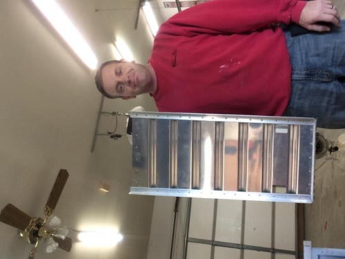

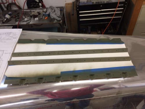

For the seat, I finished drilling the angles to the seat sides, top and bottom. I deburred everything, primed, and riveted the seat together. I then cut the piano hinge that attaches the seat to the fuselage to length, primed, and riveted it to the seat. I then cut the cutouts for the seat belts. The front seat is basically done.
Primed seat front, and angles
Fabbed the F443 brackets.
Front seat all riveted, with hinge!
