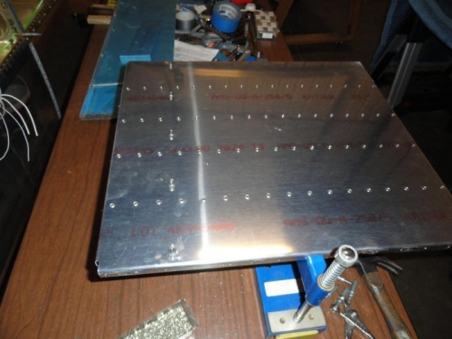

Date:  11-26-2011
Number of Hours:  1.00
Manual Reference:  35-2
Brief Description:  Prepare right rear floor for riveting
I match-drilled the right rear floor pan and then removed it. I had to repair a bend at the front right and then applied a bit of primer where the alclad had been compromised. I then dimpled all the bottom holes for CS4-4 rivets and also the nutplate holes for the K-1108 nutplates, before riveting them in place. I need a close-quarters dimpler to do the floor stringers before I can install the pan.
Rivet count: 10 Total: 14536 - Plus 549 done at Van's
