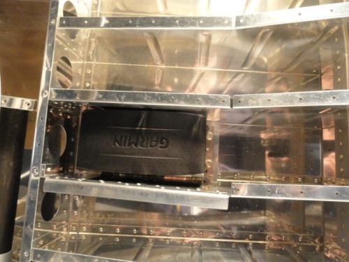

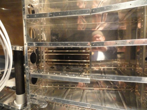

Brief Description:  Install AHRS mount
Installed the AHRS mount with LP-4 rivets. Then added the reverse flange for the rib on the right and its doubler. Finally, installed the AHRS to check the preload per the installation notes from Garmin.
