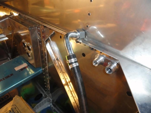

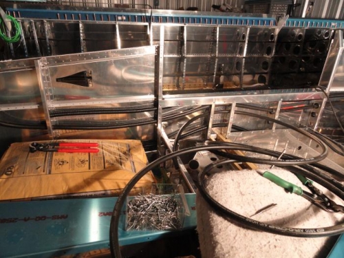

Brief Description:  Started installing A/C hoses
Started installing the compressor hoses today. I ran the larger hose through the bushings from the tail cone to the firewall. At the firewall end, I installed a 90-degree fitting and used the crimper to secure the clamps. Then I installed the fitting on the firewall pass-through and pulled the hose tight back to the tail cone. I started to install the smaller hose, only to discover that it did not fit the snap bushings and the clamp rings for the smaller fittings are missing. I'll have to get some new parts before I can continue with this task.
