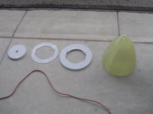

Brief Description:  Spinner parts
Clecoed the spinner backplate to the doubler and traced the outline of the opening for a constant speed prop in it. Used the hand nibbler to cut out the opening and finished with file and scotch-brite wheel. Temporarily fitted backplate to prop to determine location of spinner cutouts and then laid out the attachment points. Placed the spinner over the backplate on a flat surface and drilled them together at the attachment points.
