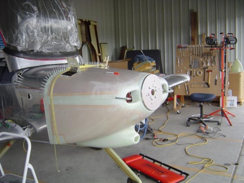

Brief Description:  Bottom cowling fit

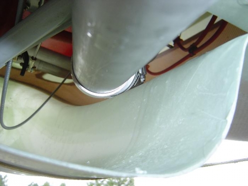

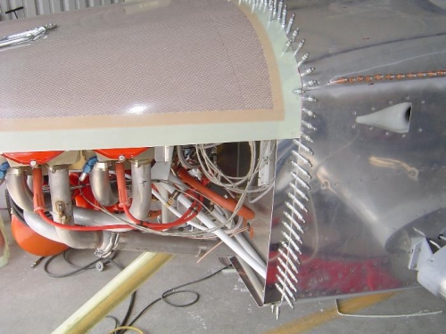

Fitted bottom cowling to top cowling, trimming away flange as needed. Fit both cowlings to firewall and made up cowling attach strips. Trimmed bottom cowl to fit and drilled to attach strips. Noted interference with exhaust pipes. Also located fuel purge line on right bottom attach strip and relieved cowling to fit around it.
