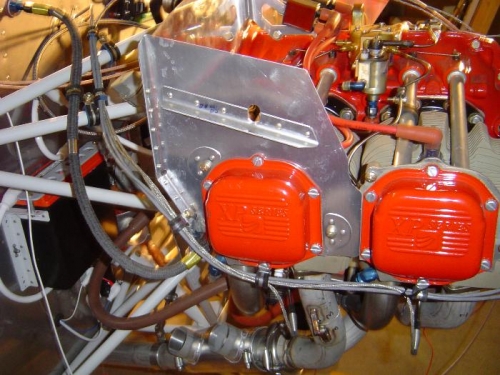

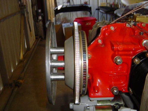

Made 2.125" spacers and installed spinner backplate to engine crank to prepare for cowling install. Continued to clean up wiring runs, installed clamps for right side engine run of lightspeed sensors, CHTs (and EGTs when installed).

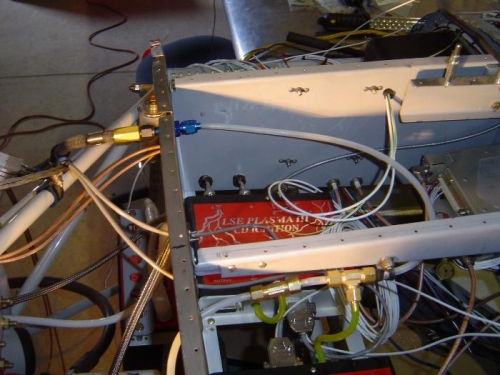

Installed manifold pressure line from firewall bulkhead fitting. Used leftover pitot line to run from flare fitting to two "tee" fittings, compresstion type. Final run was from "tee"s through firewall to oxy-style quick connect on BMA engine pod. Tygon line was used from the "tee" fittings to the lightspeed inputs.
