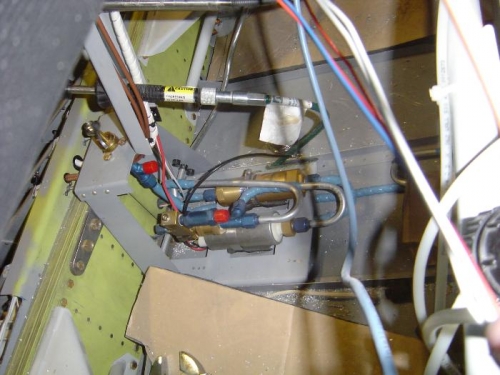

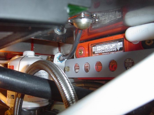

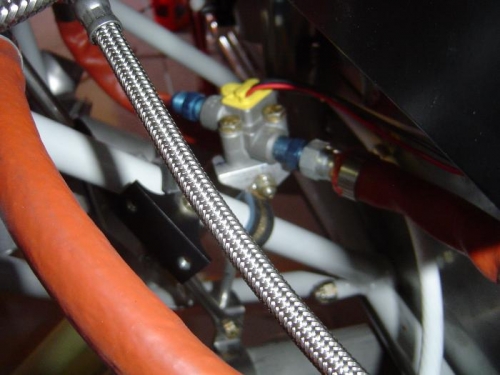

Brief Description:  wiring cleanup, prop and trim controls, Floscan
Installed prop control and ops checked. Installed eyeball firewall passthru, did not final route in fuselage yet. Cleaned up wireing around central column, installed spiral wrap and anchored with wire ties to beneath instrument panel. After more attempts at planning a location for the Floscan sensor, finally located it to the engine mount with an adel clamp and fabricated bracket. Ordered parts to replace VA-129 hose with custom hose for run from Floscan to throttle body.
