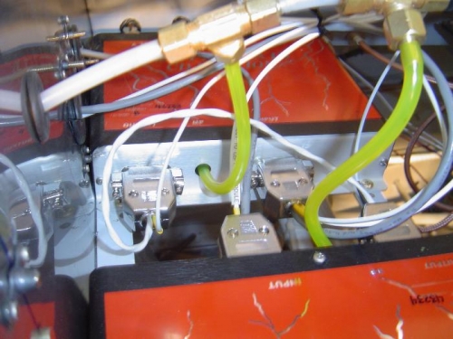

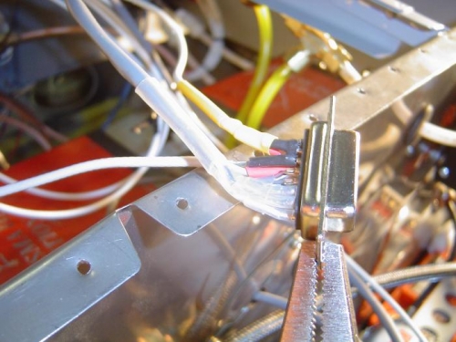

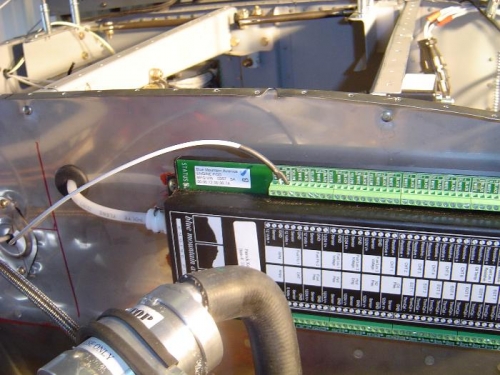

Brief Description:  Wiring of Lightspeed ignition boxes
Disassembled the input connectors for the Lightspeed ignition boxes and soldered the shielded power lines from the Aerotronics panel to each of them. Additionally, on the right input, added the pulse tachometer output for the Blue Mountain engine pod and routed the wire to the pod. Reassembled the connectors and connected the ignition boxes. On the pre-wired output crossover I soldered a shielded single-conductor wire for the key-switch option. The other ends of these wires (2) will be connected to P1 for the Aerotronics panel. Assembled the connectors and connected them to the ignition boxes and then routed the leads to the general area for connection to the panel.
