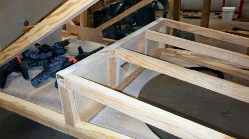

Cut and installed seat support columns for rear seat. Need to varnish under seat area BEFORE the rear seat top ply goes in because it will be difficult to do (to spray anyways) later on. Could just brush it on later - we'll see how that goes.

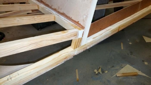

Since the outside skin is a structural member of the seat (as well as the airframe), I left the outer supports slightly proud of the fuselage side. This will be sanded flush for a good bond when the outer skin is installed.
Note the outer support standing proud of the side...
