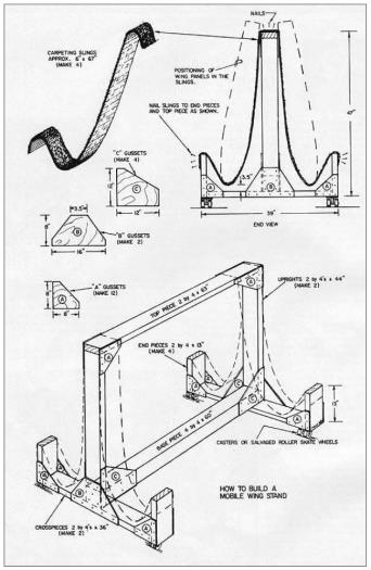

I found these plans for a wing rack / dolly from 1987 on EAA's website, and I figured this would be the best solution for me to conserve space in the garage. It's better than hanging the wings from the ceiling or the wall, as I can roll then around, mount the controls surfaces and work on the wing tips.
EAA article plans from 1987

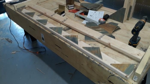

Building the wing strap holders

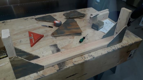

composite 4x4
composite 4x4
