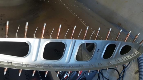

Brief Description:  2 - tip rib fitment
I had to remove the spar attach brackets from the ribs and attach them to the spar first in order to be able to rivet them.

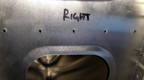

The holes on the main spar bracket were not aligned very well, especially on the right side, so I drilled them out to 3/16" after clecoing the perimeter of the rib to the skins.

hole misalignment
hole misalignment
cleco'd ribs in place
