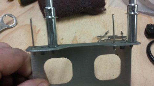

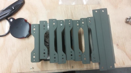

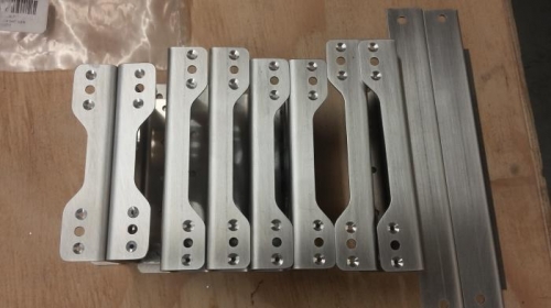

I countersunk the 3/32" rivet holes for the nut plates on the fuel tank mounting brackets, scuffed the mating bolt surface with scotch bright, cleaned with alcohol and then primed. I then installed the nutplates with countersunk rivets and riveted them in place.
CSink & preped brackets
primed mating bolt surface
riveted nut plates
riveted nut plates
