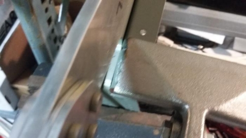

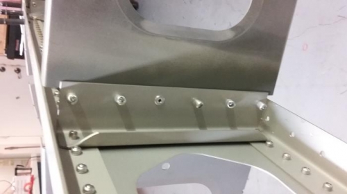

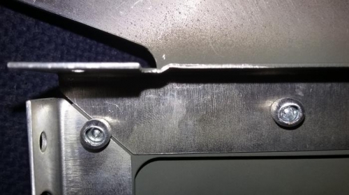

I completed the step bends using a hand bender to finesse the form, and clecod the ribs in place. While clecoing the ribs in place I notice that rib 9L hand only one hole that lined up. Not sure why; it might have something to do with the landing lights. I drilled out the remaining holes for 3/16" rivets and then riveted in place.
finessed bend with hand bender tool
completed step on brackets
Rib 9L holes re-drilled
