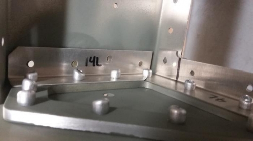

1-Formed step on bottom rib brackets

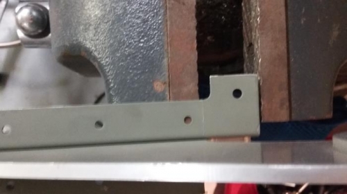

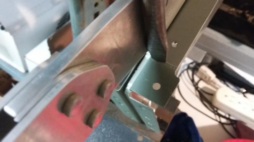

I formed the bottom step on the flap / aileron rib brackets of the left wing using a flat blade screw driver, small hammer and vise jaws as an anvil.
marked area to bend
place on vise jaws as an anvil
tapped with a screw driver
