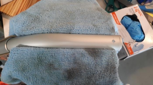

3 - Installed stick grips
I marked the tubes 1/2" from the end, drilled a pilot hole and then drilled a clearance hole for the 10-32 locking screw. I then installed the grip mounts, re-assembled the stick controls and then installed the stick grips. Looks good!
pilot drill for locking screw

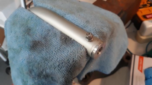

installed grip mount

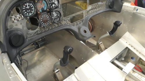

installed sticks and grips
