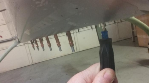

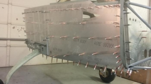

Brief Description:  Final Install of Right Outer Side Skin with Clecos
I never heard back from TAF on how to deal with the hole alignment so I soldiered on and figured out a way. I started by inserting clecos in the skin about 1/3 of the way up from the bottom figuring I could call this the base line and force the skin in either direction. I then used a small awl to located and force the skin over the bottom panel rivet holes. After I had a few clecos in the bottom, I put a few more at the top. And thats it, just worked it like a fabric to flatten it out.
I'll do the left side next and probably not rivet anything yet until I finish and join the rear fuselage. If there's one thing I've learned its easier to remove 50 clecos than150 rivets!
Using an awl to center holes
Ready for rivets
Ready for rivets
