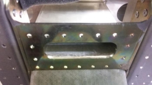

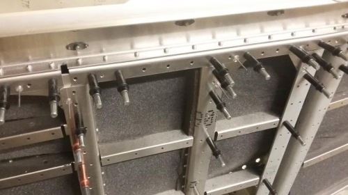

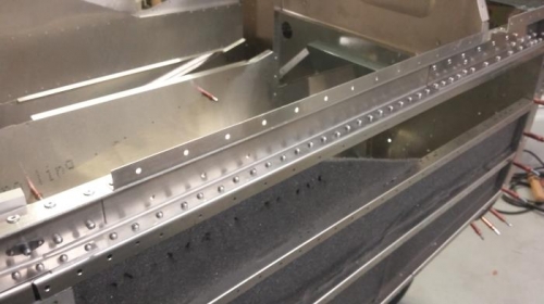

I drilled new rivet holes between the matched drill rivets and riveted assembly. I then drilled holes for gusset retaining rivets, countersinked and installed rivets. I also sanded any burrs on the rails and the two top corners of the steel landing gear bracket and coated the bare areas with primer.
New rivets installed
Gusset retaining rivets installation
Power sanded burrs
Power sanded burrs
