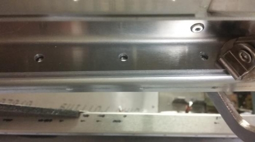

I started installing the right side top rail assembly today. This should go much faster than the left side as I now know what to expect and how to address the issues. I matched drilled the factory holes that are mis-aligned perTAF-South Africa and installed rivets. I will then go back and drill new rivet holes to correct hole tolerance between the original ones that needed match drilling (I count 13.)
Match drilling holes

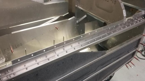

Installing top skin angle

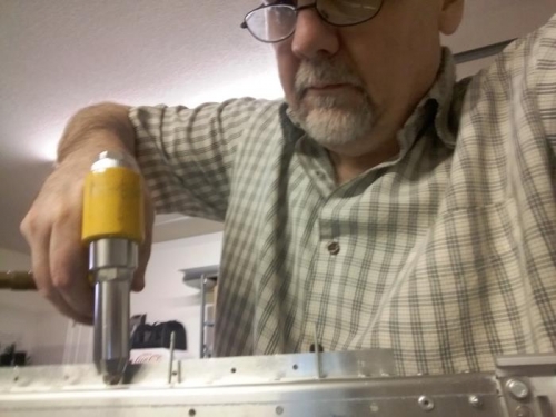

That's Me Riveting the Top Skin Angle
