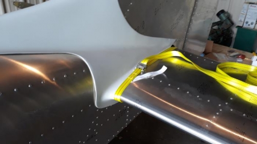

I fit the tail fairing and held it snug against the horiz stab with two tie downs. I then measured and marked the locations for holes, drilled and inserted clecos.
straps holding fairing snug

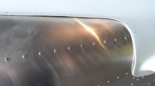

measured and marked holes

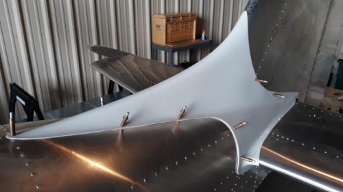

drilled and clecod holes
