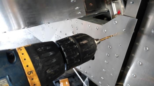

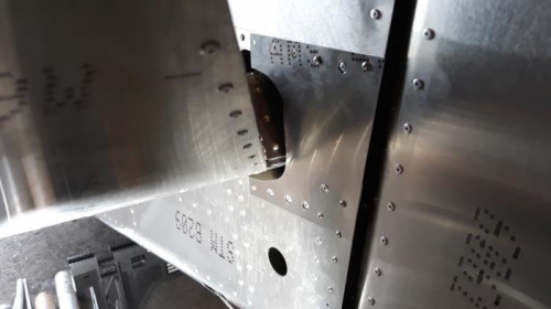

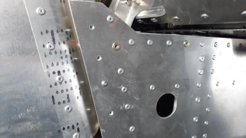

I drilled out two rivets per side at the end of the tail, enlarged the holes to .193" and then installed M3 rivnuts in these holes. I then installed the sheet metal covers with M3 button head screws and blue loctite.
installed covers
installed covers
