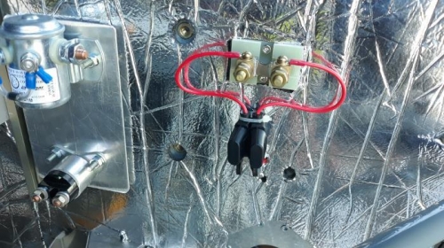

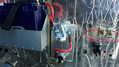

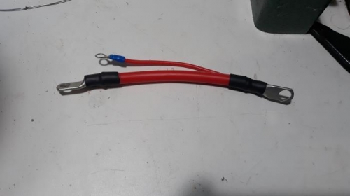

I fabricated and installed the shunt fused wires, battery to solenoid cable and battery solenoid to starter solenoid cable.
1 amp fuse holders for shunt
6 awg battery to solenoid cable
batter solenoid to starter solenoid cable
