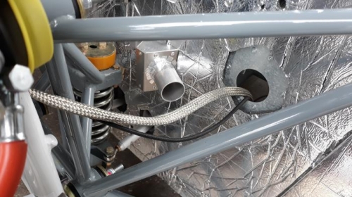

I ran the alternator and tach wires through the firewall to make sure the length is good. The voltage regulator is installed next to the hole, so it will reach just fine.

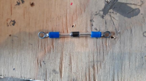

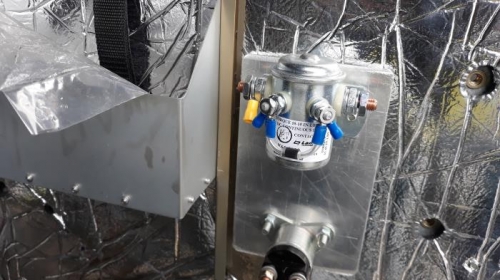

I assembled a diode to two crimp connections, solder the leads and heat shrinked. I then fit this temporarily to the battery contactor solenoid. This will prevent voltage spikes when the master switch is operated.

wire feed through
wire feed through
assembled diode for contactor
diode fitted to contactor
