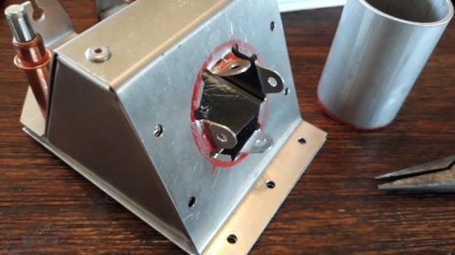

After a month of hiatus from the airplane, I recieved most of my missing parts and now have enough work to keep me busy on finishing incompleted tasks.
The plans for the cabin heat box call for a separate part to mount the pipe, but upon closer inspection, the strange design on the existing box are the unbent tabs that replace this part. I marked the diameter of the pipe, bent the tabs up 90 degrees and finessed them with shrinking pliers. I then measured the height location of the first hole, drilled it, and then inserted the pipe to drill the opposite hole. I did the same with the adjacent holes, deburred and clecod the asssembly to the firewall.
Formed mtg flanges for pipe

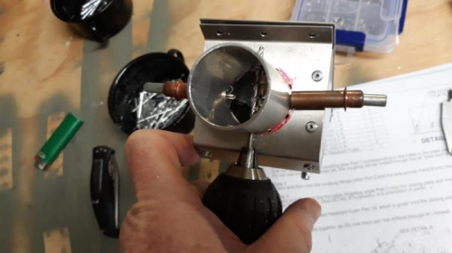

Drilled rivet holes in pipe

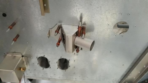

Clecod cabin heat box to firewall
