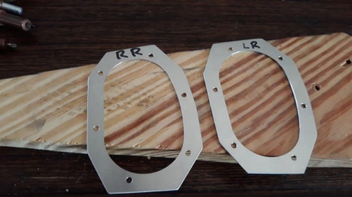

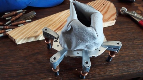

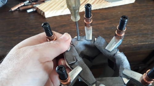

I labled the direction and side of the boot flanges, oriented the boots in the flanges symmetrically so that I could pull the cable ties in the upward direction when ready and then clamped the boots to the flanges. Using an awl, I poked holes in the leather through the rivet holes of the flanges and inserted clecos.
labeled flanges
labeled flanges
clamped boot to flange
using an awl to poke holes in leather
