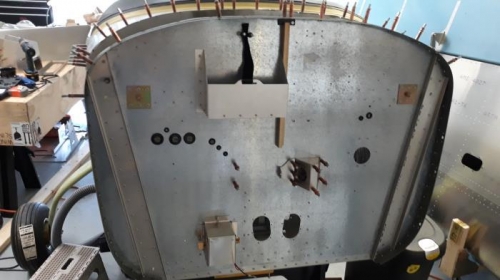

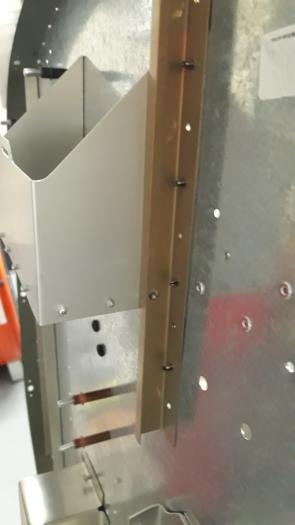

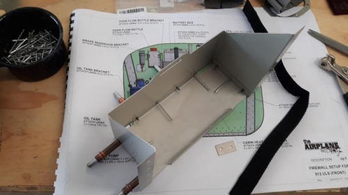

I clecod and riveted the battery box together. There are no instructions for this so I had to make a lot of assumptions as to which way the rivets are installed. I chose to install them from the inside out so the shop head doesn't interfere with the battery. I don't have a battery to test it with yet, but I figured this would be the safest choice.
I had to install the 4, 1/8" rivets to the firewall with the shop heads internal to the box since there is no room in the box for a rivet gun at this point.
I also installed a collection of grommets in the firewall.
