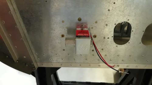

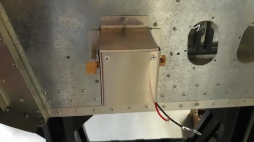

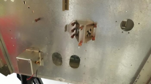

I installed the 5 M5 rivunts in the firewall for mounting the fuel pump and shroud. I then fit the fuel pump and shroud with screws and then loosely installed the fuel line fittings. I also clecod the cabin heat diverter box to the firewall for placement.
I'll be fitting most of the items to the firewall so I can eventually cut and fit the fire resistant foam to the firewall.
rivnuts installed for fuel pump
fuel pump shroud and fittings
cabin heat diverter box fitment
