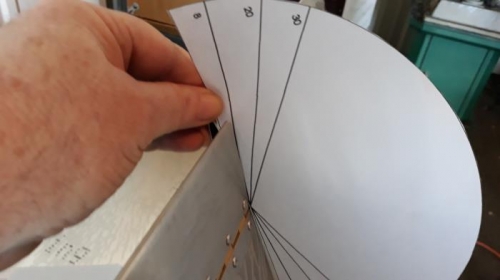

I set the trim linkage for an 8 degree deflection at the maximum servo extension according to the manual.

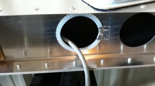

I also installed a grommet in the horizontal stabilizer for the feed through wire of the servo.

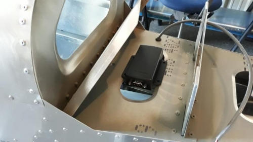

I located the home for the magnetomer and made measurements to fabricate a bracket.
Set the trim tab to 8 degrees at max extension
installed wire grommet in HStab
locating magnetometer
