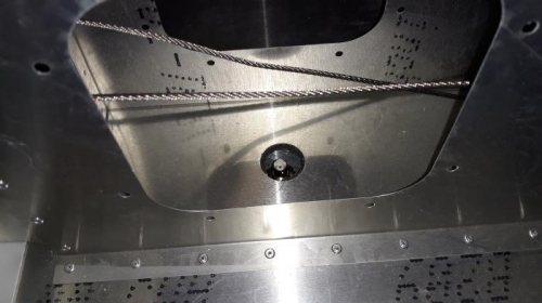

I drilled a mounting hole and installed the transponder antenna through the double-skinned floor through the access hole provided in the interior skin. I created a new access hole at the firewall, and drilled a mounting hole for the ADS-B "IN" antenna and installed it as well.

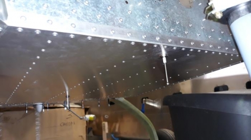

The marker beacon, transponder and ads-b in antennas are all about 26" apart.

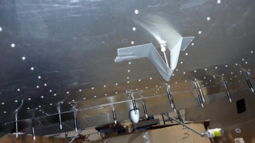

duct taped antennas while installing mounting hardware

Left to right: MB, Xpdr, ADS-B IN
