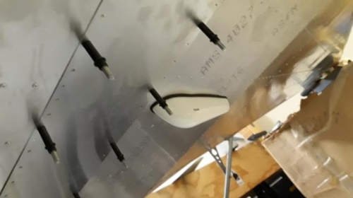

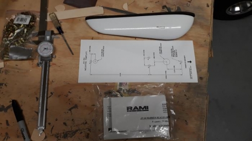

I fabricated a backing plate for the marker beacon antenna, located and match drilled the template to the lower fuselage skin just behind the landing gear and then installed the MB antenna with the hardware provided.
Marker beacon antenna and template
backing plate fabricated and installed
MB antenna installed
