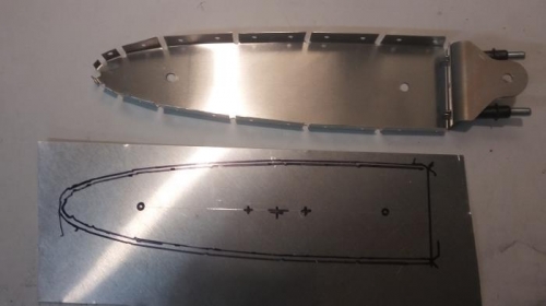

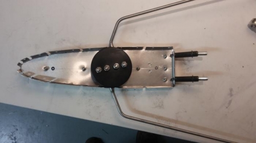

Mounted VOR antenna to VStab

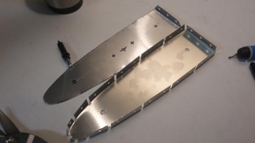

I frabricated and antenna doubler to mount my VOR antenna to the VStab. I think this an option that I didn't buy at the time, so I had to make and modify parts for this. The drawings had dimensions for the supplied version.
doubler template
shaped, formed and holes marked
antenna mount complete
