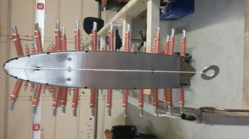

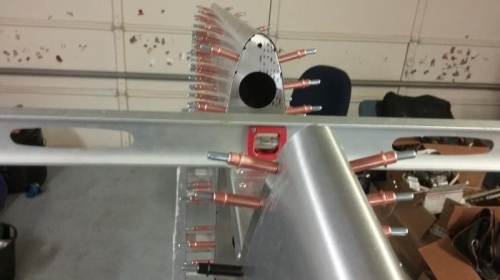

Brief Description:  1 - Horiz Stab Fit, cleco, adjust and rivet
Removed one side of the left skin, repaired bent rib, and cleco'd. Drew vertical centerlines on each end to check straightness and found one side to be off about .1". I then removed all cleco's on one side except for those on the trailing edge and adusted leading edge by hand. Finally I installed cleco's two or three at a time from either side manipulating the skin to the direction it needed to flow. It was time consuming but worth it, as the straightness is near perfect now. I riveted to all of the left side except for the trailing edges which I will do after I do the right side so I can lay the stab down for easier access.
leveled horiz stab
leveled horiz stab
port end
port end
starboard end
starboard end
