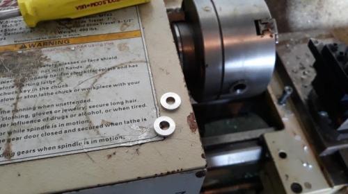

2 - machined spacers for elevator rod end connecti

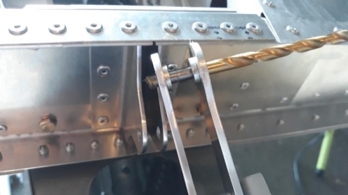

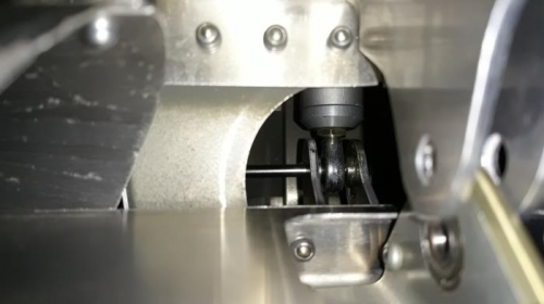

I had to machine two spacers to make up the width of the rod end connection to the elevator. I used grease to hold the spacers in place while I inserted the rod end.
machined AN4 spacers, 3/32" thick
pre-installing spacers
fitment of rod end
