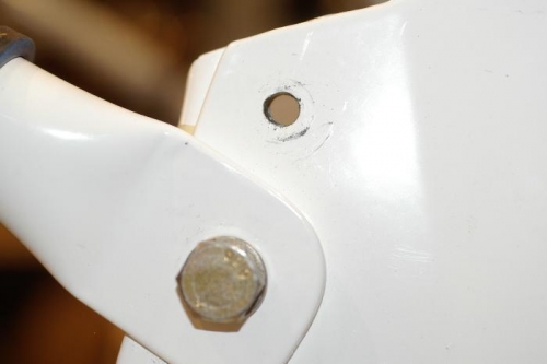

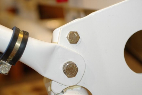

During the reversal I encountered a few very slight unexpected glitches. that were easily remedied.
Reversing the forward landing gear lowered the front of the ship a little (not sure how much) therefore the rear landing gear shoe tited forward leaving a gap at the rear of the skid shoe between the shoe and the skid. The remedy was to remove the upper bolt of the two bolts attaching the rear landing gear to the airframe and rotating the rear landing gear until the gap was closed. Enlarging the now misaligned bolt hole from 1/4" to 5/16" securely reattached the landing gear to the airframe.
