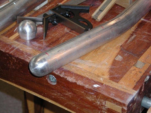

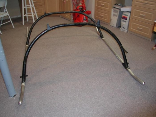

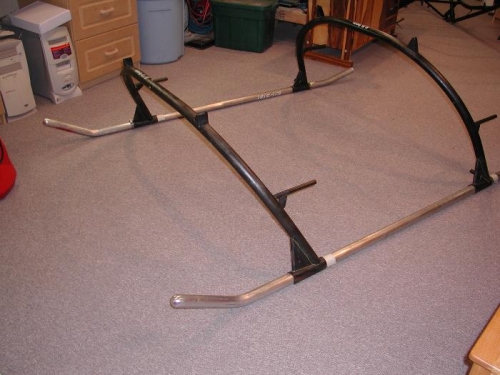

The only difficulty in this operation was making sure the bolt holes were perpendicular to the skids. In retrospect it would have been easier to drill the skid shoes on a drill press and then mate with the skids and then use the skd shoe holes as a template to drill through the aluminum skids.
Skid caps went easily!
