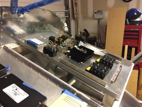

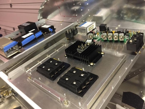

Brief Description:  Added relays to avionics shelf
Dean drilled and tapped the avionics shelves for 6-32 stainless bolts where they meet the cross bar. He installed the screws and small rubber washers. We bolted the relays for the flaps and fuse blocks to the avionics shelf L angles. We bolted on the brain for the low level fuel light.
