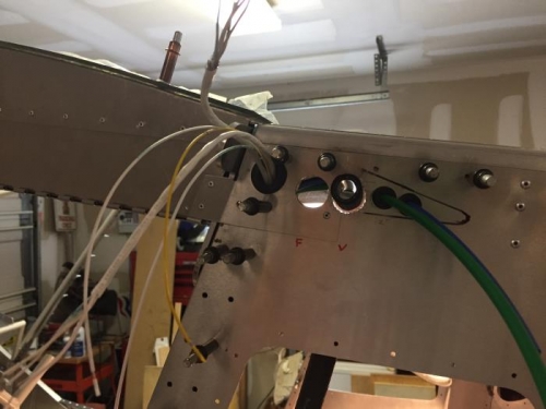

Brief Description:  Pulled the pilot side wiring

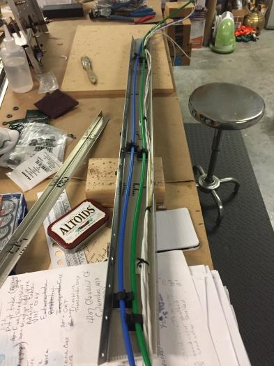

Drilled the holes on the pilot side for the wiring from the wings. Drilled two small holes for the pitot and AOA tubes. Ran all the wires and tubing down the side channel cover. Drilled some holes through the torque tube support for the pitot/AOA tubing. Connected the coax cable for the UAB and transponder antennas. Spliced the connectors for the OAT wires and connected to the ADAHRS.
Wiring in side channel cover
Pilot side
Pilot side
Pitot and AOA routing
