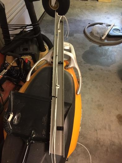

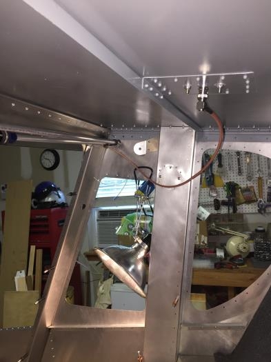

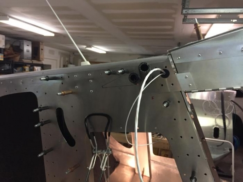

Brief Description:  Ran wire down the Pax side channel
Drilled a hole just forward of the fuel and vent lines on the Pax side for the Nav/strobe light and fuel sender wires. Added a grommet. Bundled the wires and added stick on tie clamps down the channel. Also, added the Comm coax and ran that down the channel. Started work on the pilot side which will duplicate the passenger side.
Wires in the side channel cover
Ready for molex connector
VHF comm coax
VHF comm coax
