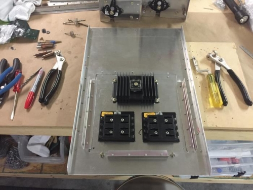

Brief Description:  Knobs on Pax side avionics shelf

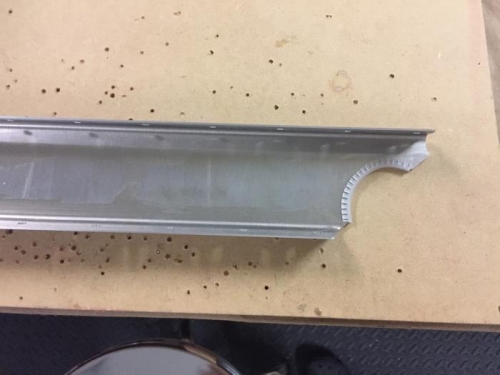

Riveted L angles around trap door on avionics shelf to give door something to seat against. Then installed two twist knobs to secure door. Removed the cover of the Pax side channel in order to cut an opening in the top. The opening will allow the wire bundle for the wingtip light and strobes and the fuel sender wire to run down the inside of the channel. The wires from the wing and the fuselage will join at the fuselage with a molex connector.
Knobs to secure fuse block door
L angles for door
L angles for door
Door support and opening
